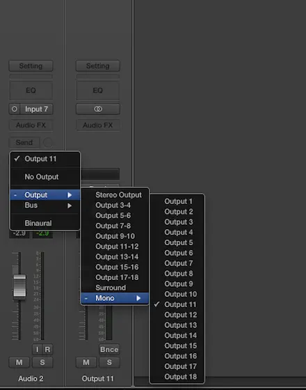

i work with logic pro X . connected to RME FireFace 400 audio interface ,
i used the all 6 outputs of my RME , and i wanted to add more outputs to spread my mix into my analogue Alan & Heath mixer,
so i have bought Behringer ADA 8000 to use it via optical cable connected to the RME
my question is : how can i assign an ADAT out in my Logic pro to start use the out of the 8 channels of my Behringer ?

Logic pro should list all your outputs, adat included, regardless of what is or isn't plugged in.
At my setup, Protools shows me 8 channels of adat I/O (motu 828), but there's nothing plugged into them.
If the I/O isn't listed, you might need to browse through your settings and see what's what. I don't know logic well enough to direct you.
The fireface has 18 outputs so everything seems to be present and correct.
You'll just have to work out which is which for yourself.

Your RME driver controls what is reported to your DAW. Probably there is something in the driver setup you may have missed. The driver interacts with the DAW and the interface, so check your driver settings, make sure it set up correctly and understand how it works, then you can set up the DAW as required.
I can see the ADAT outputs in my Cubase , but not in Logic !

WELL ..i found that ADAT is starting from 9 to 16
the problem now : no sound coming from output 1 of ADA 8000 to the mixer :(
any one have some tricks in ADA 8000 and RME FireFace 400 with the Matrix map of it ?
YESSSSSSS
I DID IT .. it was just adjustment from the STUPID Matrix map in my audio interface :D
