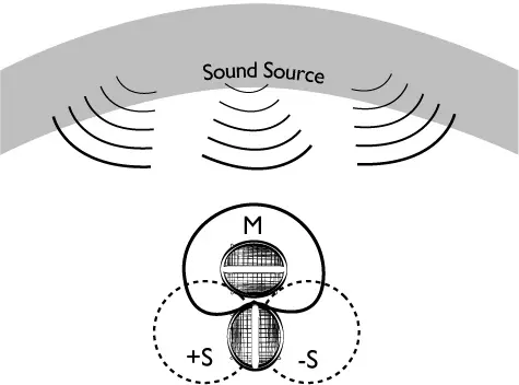

Here's a picture of mid-side. Note that the phase is reversed between the two side mics.
