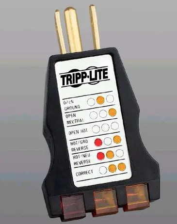

Get one of these (see pic) from Radio Shack, Lowes, Home Depot, etc, and check your outlets.
Even with the AC in order you might have to lift the ground on one of the devices (I can't remember if the 80-8 has a 3-prong plug grounded plug or not).

As far as the AC. if it was wired wrong wouldn't the units buzz on there own (when functioning) as well as when they are interconnected?
Yeah, you want to keep audio cables away from things like transformers and switching power supplies. Winning the war on hum takes some planning and rearranging if needed as the studio grows.
Whether a device hums/buzzes or not depends on how the manufacturer dealt with grounding. A lot of equipment has separate signal and earth grounds, and some older equipment has no chassis ground at all. But if it does and your house wiring is wrong the wire that’s grounded to the chassis won’t be connected to the grounding block at the fuse box because it’s on the wrong side (white wire is where black wire should be on the outlet). Tracking down ground loops and other hum producing sources can have you pulling you're hair out.
