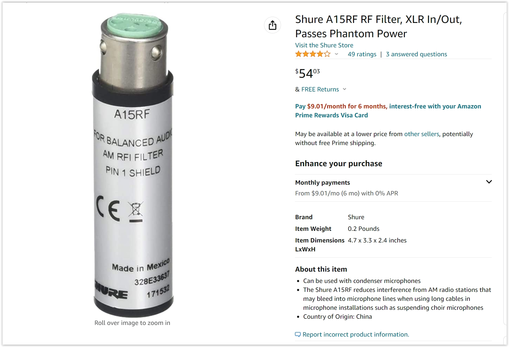

In order: Try to establish that the problem definitely is the Cloud Lifter by, as I said, cranking the gain on the 2i2 and boosting the signal digitally. You will need to cover the microphone with layer of say a duvet to keep extraneous noise down.
If you can prove the CL to be the problem, email them and ask for help. If it is the F'rite picking up the RFI talk to them.
Try some ferrite absorbers but, until you learn to solder XLR connectors you will need to seek out some 'clip on' ones*.
If all else fails, try the XLR filter then there are other cascade mic amps. I have use a Fet Head without issue. there is the 'Dynamite' (order that in a plain wrapper!)
*I shall see if I can find you a link. The above looks good. Pretty cheap so buy a few. You wind the mic to CL cable in it and clamp it.
