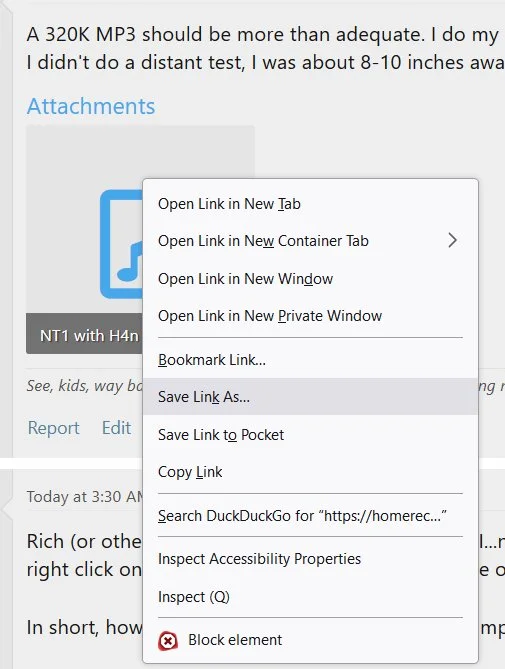

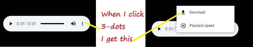

Dave, did you try right clicking on the attachment and use Save Link As: ? Rename and save. I switch between Firefox and Chrome, depending on which computer I'm on.

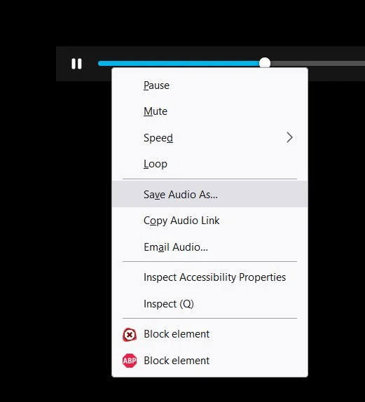

Yes Rich but that only got me the LINK which plays the file. I want "Save Audio as" directly. Used to be "Save Target As" back in XP days.
No matter mate, I can now get the audio albeit in a roundabout way. Many thanks. (to quote a very famous brilliant movie "I didn't BUILD the $%£"ing thing!)
