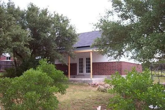

Construction - Hmmm... I'll be finished one day, I think.
The exterior is done! Finito! 100%!
Actually, today, I'm insulating and sheetrocking the rear wall of the studio so that I can finish framing the rear wall of the control room.
Inspectors here want to see the insulation installation (say that real fast 3 times) before you can sheetrock. So I can get them out here monday for that, and for a final inspection on the framing soon after.
I had a bunch of rockwool delivered this week, not enough to do the whole studio, but all I can store and work with for now. I also had a BUNCH of 703 delivered too!

This is kinda what it looks like now:
