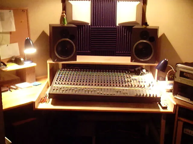

Here's a couple of shots of my homemade furniture (not fancy but functional). The pix are outdated, but give a flavor of the construction. I've since upgraded to a Mackie 32x8 console which fills the entire width of the desk, and have replaced the ADATs with a Mackie MDR HD recorder.
The desk is 3/4" plywood on top of a frame made from 2x3's. I used framing angles from Lowes to tie the 2x3's together. With the support added by the 2 side units it is rock solid.

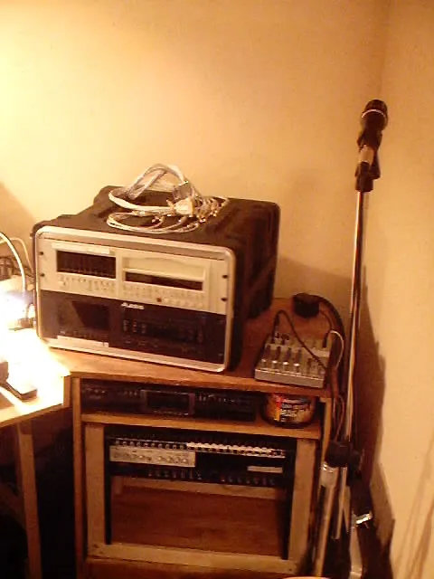

The equipment rack is a modified printer stand. The internal rack has heavy duty rails to allow it to track out for access to wiring.

And the rack...
