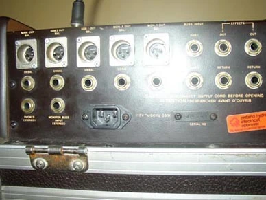

What are those? What could I use this for on my mixer? I'm pretty sure would of used it himself when he was using it. Here is the back of my mixer next to where all the mic XLR are etc are.

Sounds like a snake built for hi impedence mics. Most all decent mics from the SM-57 on up are low impedence. The way it sets, it wouldn't be of much use to me anyway. If the individual cables have two conductors and a shield I suppose you could replace the 1/4" connectors with XLRs of the opposit gender of whatever XLRs are at the other end. Or replace the XLRs with 1/4" and use it line level stuff.
