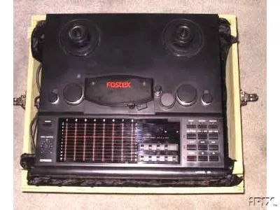

I am looking at a Fostex 80 on Ebay Australia, (see pic), but know virtually nothing about that model. Do you have any idea what a fair price may be in the US?
I intend to add a R2R to our setup here to supplement the Fostex D160 16 trk H/disk recorder. I still have to figure out what will be necessary to allow me to synch the two together, as apart from the fact that I would have to sacrifice one analogue trk for timecode I know very little.
The joys of playing with gear...............

Hello ausrock, do you know for sure there is some kind of port for timecode, like a dsub or accessory port? Or the machine can read timecode? My MSR's have a port for connecting a midiizer, which generates and reads smpte. I'm not familiar with the fostex, but I would check if unknown. And as far as limits, what limits. ANY 8 track reel to reel is fun!!! Oh, for what its worth, I fooled around with one of these years ago, and I had a ball with it. As far as synching, I don't know its capabilitys. I know you probably could use one of the JL Cooper or Yamaha synch boxs, that will read and generate smpte, but I think the transport has to respond to timecode in order for it to chase a computer or other device. I could be wrong though.

Hey Rick.
I was just emailing the seller at the same time you were posting here...........lol.
I don't know that there would be a port on this model, however I believe it is possible to get some of these 8 trk machines to synch. I think I will contact the Fostex distributors and see what they can tell me.
If the seller has a low enough reserve, this thing may be worth getting regardless of whether or not it can be synched to my other gear.

Arrow The Fostex Model 80 is plug compatible with Fostex syncronizers,...
such as the 4030/4035, syncronizer/controller. You lose one track to timecode, and the connecting cables can be hard to come by, but hopefully a full set would be shipped with the 4030.
This 4030/4035 system is capable of locking two Fostex analog reels together, or vtr, or presumably the 'puter. too. I'm pretty sure the Fostex 4030/4035 will sync non-Fostex decks too, but you're in DIY-land on CABLES.

Arrow A Fostex 4030/4035 syncronizer/controller will lock two Fostex units together, M/S,..
in full Smpte lock.
I think the JL Cooper boxes will facilitate the analog reel as code-only master, with nothing fancy.
I have each piece of the aforementioned Fostex gear, but have yet to hook it up and figure it out completely. Being an economical format, and Fostex-to-Fostex plug-compatible on sync is a big plus.
The Model 80 was designed to accomodate autolocate and sync.
It's an 80's deck. Get one in good condition, and it can be a nice deck to have. I'm a vintage collector. I think I have two.
