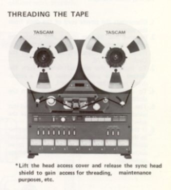

Arrow Tascam 388 - tape loading diagram

Arrow Tascam 38 - tape loading diagram
Second verse, same as the first...

Behind? Nooo..... Below.
The tape should go 'south' of the tension wheels (thats the small weels far to the right and left that moves). It should go between the capstan and the pinchroller. The capstan is the small steel pin, and the pinchroller is the rubberwheel that pinches the tape to the capstan when running. It should go north over the two remaining wheels (otherwise the tension wheels has nothing to "tense" against. )
It should also go south of the head stack.
After loading, make sure to pull up any slack in the tape. The tape should lie directly against the heads, and the tenstion wheels should be pulled up by the tape.
Oh, and check in here: http://www.voxvendor.com/chat/ for online help.

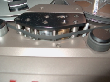

heres a closer view

Yes, you are making it too complicated.
Threading tape does not involve any actual threading.
The tape goes below ALL of the head assembly. Everything of it.
And also, you haven't gotten the tape between the capstan and the pinch, and that means that there is nothing to pull the tape forward.

Arrow DUDE, WAIT, THAT's ALL WRONG!
Regebro, excuse me, but shut up for a moment!
Your tape should go UNDER the tape-guides/tape-head-stack assembly, and BETWEEN the capstan & pinchweel.
You have it threaded ABOVE the tape guides, and THROUGH the headstack assembly, and then ABOVE the capstan. THAT's CLEARLY WRONG.
Work on it some more, & I'll follow up with a webcam pic of my own, asap.

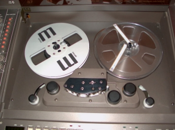

Arrow Yes regebro, so sorry to snap like that! I apologize.
It's pretty hard to escape your genius, though!
>> Tape Loaded on Tascam 388

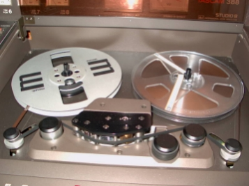

Head Stack, 388

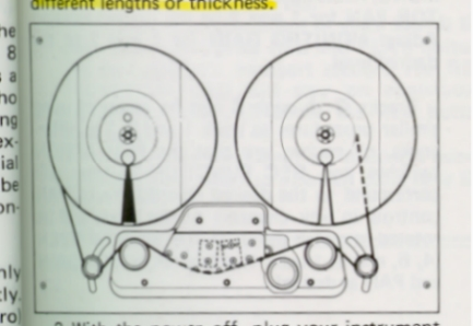

Tails-Out, 388.
After the session, wind all tape from the left reel onto the right reel in PLAY mode. This creates a nice, neat pancake of tape that's better for storage, since it helps prevent tape-edge damage from handling, that you'd be prone to if the tape was stacked unevenly, like from FF/RW.
Store reels in boxes, standing on edge instead of lying flat, whenever possible.

oops i had the reel on the left side....
it seemed to be recording fine that way though, i better switch it though?

With the reel in tails-out configuration, as in above photo, implied is that you'd do a full REWIND before each session, then wind the tape tails-out after the session.
In the photo above, my reel's already in tails-out configuration.
In general, the mass public thinks of putting the full reel of tape on the left side. That's normal. However you do it on the first shot is not important, as long as you wind the tape in PLAY mode all the way to the right, after the session.
Also implied, is that if you're destined to use tails-out, then you'd probably want to put the new reel on the right, so as to keep the tape on the original reel it came on, out of the box.
Beyond that, it doesn't matter that much, especially if you have a few empty reels available. Just be certain to label each tape as well as possible, plus keep a track sheet, if possible.
