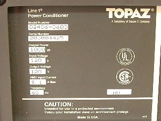

anyone know of these power conditioners..(sjoko??)
here are some pics that Mr. Patchbay sent me for his 1000 watt conditioner.
Said he would get one in a little bit, as he is out of the 1000 watt version. Looks like a box to me . In other words... does Bob get a variety of these from different industrial setups for resale? Does this look like what I need for my small setup? Decent surge suppression and AC filtering?
Then I figure also getting a 500 watt for the computer (or two of 'em for two computers)

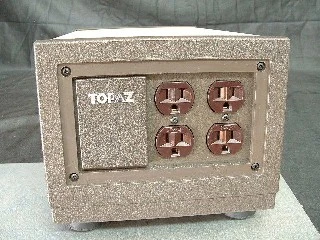

and a reverse side pic....

Topaz make extremely good conditioners, check out their homepage here: http://www.topazpower.com/
On top of that, Bobby is a completely cool and reliable guy who would never sell you anything that wasn't good.

His website says he would have 18 devices plugged into the 500watt version.
But to check the back of the devices.
So what if I plugged
Computer (300w power supply )
Monitors ( 20/20 bas powered 200w peak )
mixer ( mackie 1202 25w )
I should be safe with just one of them?
Sorry I don't own a lava lamp

You'd be fine
I think I paid 350 for the large one
Regarding the last question........ I think I'd ask your dad to calculate how much you'd need
