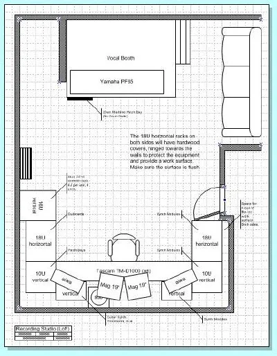

I've decided to spend most of the summer upstairs in the "home studio", tearing it out and redoing it the "right" way.
Because I had a commercial building which was to be a pro studio, I wasn't worried about the home studio being pretty, or soundproof, or really optimal in any way. I intended to simply use it as a room to blast midi compositions, then edit, and doing the real work in the commercial building.
But since thats delayed for at least a while, I decided to redo the home studio since the layout sucked, the insulation is very old, useless, and half eaten by mice, and this is also a good opportunity to rid myself of said mice, carpenter ants, and various other forms of nature that are highly irritating.
Anyway, attached is the design. Boring, simple, "good enough". Just a layout more or less. Keeping the flip-floor vocal booth because I just can't be bothered tearing it out and building it again, so it stays.
BTW, all this gear is under a slightly sloped ceiling, not that it matters that much. I figure if I keep the monitors off the wall/ceiling it won't be terrible. I'm going to be satisfied with non-terrible. I'm more interested in ergonomics

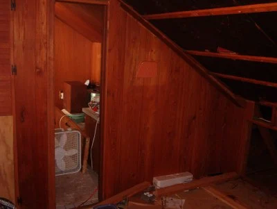

This picture is the entry way, coming from the bathroom that mates to my wife's office (3rd bedroom).
Don't look in the bathroom, it was built in 1947 and its definately a poor excuse of a bathroom.
Anyway, you can see I've already started tearing out the ceiling and part of the walls, but temporarily stopped to douse myself with a hose (and upload these pictures) since its very hot upstairs. The digital thermometer in that room says its 117 degrees. I don't find that hard to believe actually, and I attributed that to the insulation which was installed also in 1947 (the house was built in 1941). The wood you see everywhere is 3/4" thick tongue and groove cedar. It comes down fairly easily since its so powdery a good thwack with the hammer and it falls down in many pieces. I thought it was going to be harder work than it is... its only really really messy.

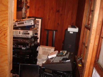

Picture 2 - more of the ceiling has been removed, one plank at a time. The black garbage between the joists is black paper with some kind of cotton glued on the other side. its coming down. I must have about 30lbs of mouse poop on the floor of the room that magically fell out of the ceiling, so I really don't want to keep this insulation. Obviously, the insulation doesn't work since the room is so hot, and definately won't work if mice are rudely relocating it.
The "stuff" to the right in the corner are horizontal 18U racks where I had my amps, my monitor mixer (Samson MPL2242), and four Akai hard disk recorders.
Just in front of that was my cheasy homemade "console table" made of 2x4's and black pipe. I'll explain more in the next picture.

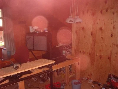

Moving right along...
Yes, I have a window. Its leaving too, and getting replaced with a nice double pane highly insulated anderson window. I won it on e-bay
Underneath the window is an "old fashioned" hot water radiator, its never worked so with the terrible insulation job 60 years ago, the room is freezing in the winter.
It will work now, since I found a valve in the crawl space behind the cedar panels, and it was set for "off". Jee, Duh, good place for a valve. I already replaced the valve with a nice ball valve since the "garden hose fawcet valve" was clearly a rotted piece of mouse poop.
The 2x4's and black pipes were my old "console table". Black pipe (normally used for natural gas feeds) is mild steel, about 1/4" thick wall, and 1.75" diameter. its strong as heck, weldable, and dirt cheap. I used it as verticals to properly support two 19" video monitors, and my two audio monitors, which I mounted to teh black pipe using clamp-on speaker mounts by ultimate systems. Amazing how a bunch of odds and ends fit together.
The black bar that goes across the front of the console (I sat with my back facing the window) is what supported the front of six Tascam TMD-1000 mixers. The black pipe could support these mixers without bending in any way, thus allowing legroom side to side the entire width of the console table.
Poor engineering, but it worked.
Yes, all that brown stuff on teh walls/ceiling is even more tongue and groove disintegrating paneling.
Ignore the mess of wires on the floor, all that crap was attached to the mixers, computer stuff, snaked to all the midi gear that was mounted all over the place. I was too lazy to untangle it, and decided raking it (like leaves) to the center of the room was the path of least resistance at the time.

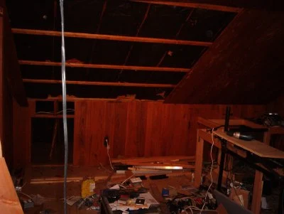

Last picture - this is a picture of the edge of the console table (which is leaving once I find my sawzall), my pride and joy (fender cybertwin), and the back side of the vocal booth. Ignore the spots on the lense, its hot up there
On the ceiling is a track with four halogen lights, of which there are two more somewhere in the attic, which I will relocate them to the other side of the room over the new console table, with low wattage bulbs, and probably different "bells". Those fixtures are too large and I've bumped my head on them a few times. I've seen smaller "spot" fixtures that will be perfect.
Instead of storing the track lighting in the attic, I simple screwed it to the ceiling for storage
The vocal booth is 4 (yes, four) 3/4" commercial grade plywood glued and screwed to a simple 2x4 frame, that goes floor to ceiling. Along the floor there is a 2x4 sill, as well as long the ceiling. In between each layer of 3/4" plywood is a 1/4" layer of neoprene. Not exactly the best design, but nothing rattles or vibrates no matter how loud anythign is turned up. And it does isolate a vocalist or instrument well enough from the rest of the studio if I'm wearing headphones. Since I record everything dry anyway, laying down these types of tracks with headphones isn't a big deal at all. I do all the EQ stuff during mixdown.
Well, there you have it, my current project. I'll post pictures occasionally as I make significant progress. I figure no one wants to see my armpit, er, studio being assembled piece by piece.
I have so much insulation, rockwall, neoprene I could coat this entire 20x13x7 room about four times! Going to use 3/4" plywood instead of sheet rock, glue and chaulk everything, then apply pergo white birch flooring and saturate the walls with auralex foam. Though, I'm considering carpet since I have enough carpet to cover all the surfaces about 6 times. Naaah, foam all the way

okay, I forgot the picture. sorry lol

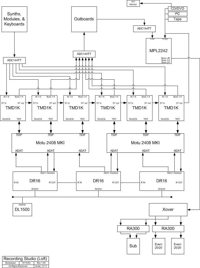

And the partial wiring diagram.
Wordclock stuff wasn't drawn, neither was the two MA-AD8's, two DR8's, and the remaining TMD4000's. Probably to be sold at some point.
Also, the video wiring between the various outdoor and vocal booth camera's aren't shown.
