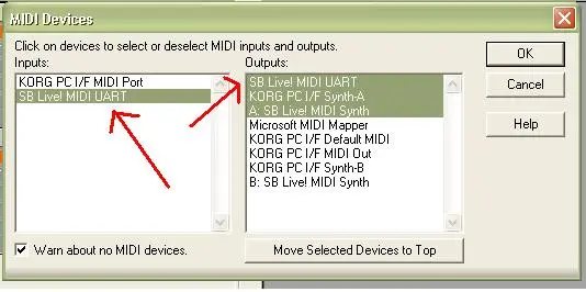

Thumbs up Tex is right...
Let me explain it step by step...
1. Install the MIDI driver.
2. in Sonar go Options --> MIDI Devices Select the input & Output to match SB MIDI Port
eg, like this...

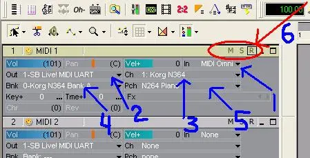

Close it, now go Options --> Instrument. Pick the instrument deffinition for the port being used. If you don't find yours, for initial, just use General Midi.
Close it...
Now, in Track view, select one MIDI track (NOT Audio track!).
Follow the steps as shown in attached picture below...
1. Assign Input to Omni
2. Assign Output to SB MIDI Out <-- this goes to your keyboard... let it be this way first.
3. Channel 1 (Make sure different track has different channel, so next track should be 2, 3, etc... Drums ALWAYS Channel 10 ).
4. Select Bank
5. Select Patch
6. Hit "R" to arm the track. It means, the track is ready to record any incoming data. Without arming the track, the Record button will be greyed out.

DAMN "R"
*hits himself hard to the head with a pointy objext*
gotta try that tomorrow ...
thanx for the input guys
