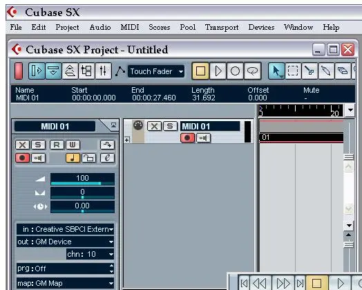

Image showing how its setup initially

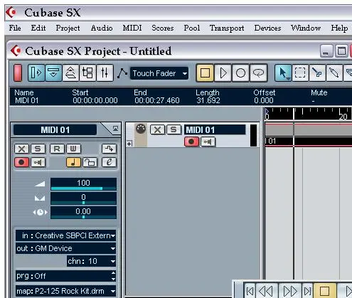

then I change the drum map to a rockdrumkit

And the only noticable difference is that when I open the drum editor, all the parts of the drum are moved around. So when I take my little drumstick Icon and begin placing beats manually in the kickdrum row, it sounds exactly the same. I thought it might have been the drummap I loaded so I tried lots of other ones to but to no avail.
What am I doing wrong?
Thanks again BTW!!!

Drum map wont give you anything if you don't have either soft synth (Software based synth / sampler) or external MIDI device to gain better sound. It's just route inserted notes to certain re-deffined key of particular given synths Drummap changes those notes value to match the assigned devices. The devices then make the sound triggered by the notes. SBPCI 16 is not supporting soundfonts as I consider. You're gonna make it somewhere if you consider to replace it (even it's brother SB Live! will be alot better as it supports soundfonts. Better card preferable). Otherwise, use any available softsynth (or soundfonts player eg. LiveSynth Pro, VirtualSampler, etc...). I don't use Cubase, so I don't have a clue about compatible softsynths available.
Hope it helps
