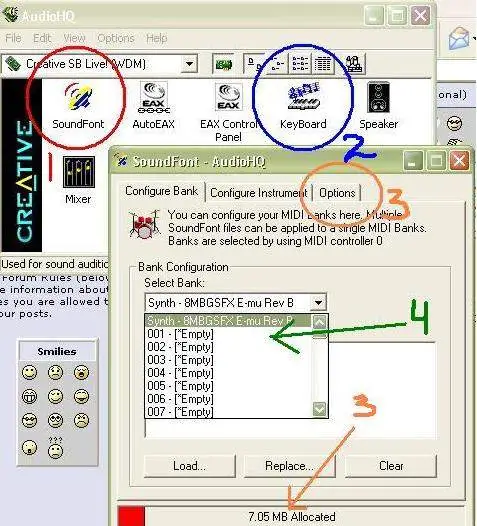

...What if I don't have any multitrack program, Jaymz ?
Okay, if you have SB Audigy (I have SB Live! DE 5.1 instead, but it would be very similiar... ) Go to your AudioHQ application <-- The one that comes with your Creative card's installation CD. Open it...

Open the Soundfonts application ( 1 )
Click options tab. ( 3 ) Move the memory slider to reserve amount of memory for your loaded soundfont files.
Back to Configure Bank tab.
Select the bank reserved, and load some soundfont file ( 4 ).
Open Keyboard ( 2 )
Now, click options, and set your MIDI In (eg. SB Audigy MIDI In port), Audition Devices, and check setting Show bank and instrument names.
Hook your Alessis MIDI Out to SB Audigy MIDI In.
Play it... If everything is set up propherly, you should be able to trigger the soundfont by now... Don't forget to enable MIDI/Synth in your Windows Mixer...
