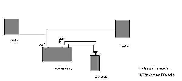

Thanks man that helps, but I don't think I'll get the picture untill I see one I guess. =) Maybe like a diagram or something? I can't find recording books anywhere. Well I can but I haven't gotten any.. Any diagrams? Thanks.

I got an adapter that has a stereo 1/8 plug that plugs into my stereo LINE OUT of the soundcard and becomes two RCA (for basic audio cable) connections. See the small triangle.
Hope that helps!

Quote:
Hope that helps!
It's $5 at Radio Shack for this RCA to 1/8" Y adapter. Make sure you get the stereo one.
kt
