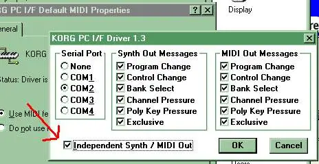

Okay, so we have slightly different setup & gears, but they should be similiar. I have Korg O5R/W hooked to SONAR 2.2XL (Windows). Using same type of interface (Cable AG-001 --> module to COM port). I hooked Korg SP-100 electric piano to the O5R/W MIDI In - Out. I never have any problem doing so. All I need to do is make sure I set Independent synth / MIDI out on Korg's driver property, so I have two independent port here. Korg Synth port goes to internal O5R/W, and Korg MIDI Out port goes to SP-100.
Korg SP-100 (as a controller) will send MIDI signal / data to PC independently through O5R/W...

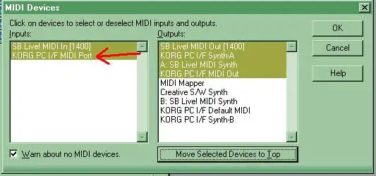

And in your sequencer, you must select this port as your MIDI in (reffer to your application about how to figure it out). For me (SONAR), I reach it in Options --> MIDI devices. Highlight it...

...and make sure your N5XR is turned on while installing the driver. And it's connected to the COM port using AG-001 cable

Anyway, I tried installing again. Tried Com1 and Com2, turned the power on and off 13 times while I danced around naked. Nothing.

Talking Ugh... my mistake...
How about this one, moskus ?
Follow the instruction... And if it doesn't work, I suspect something wrong with the cable (AG-001), you better check it for sure...

SUCCESS!
Thank you, James!
