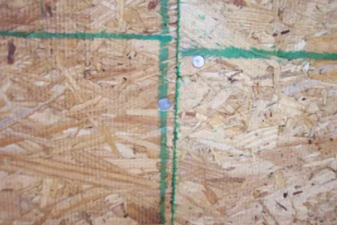

"knightfly" one of our resident construction "experts", maintains that construction should be "...to cabinet makers tolerances...".
Attached is a close up picture of a typical OSB joint. Its hard to tell in the picture, but you can't even fit a razor blade between the joints!
This is NOT difficult to accomplish. Take your time, measure twice, cut once, and when placing the panels up to be nailed, pull the joints together tight, and then nail each panel with the nails driving into the stud at opposing angles. This actually pulls the joints together. Just a tip for anyone at this stage of constrtuction.

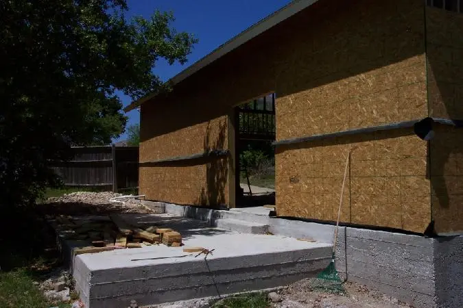

Here's a broader view.
A little "DIRT AND GRIME" for those of you that like to see that stuff.
