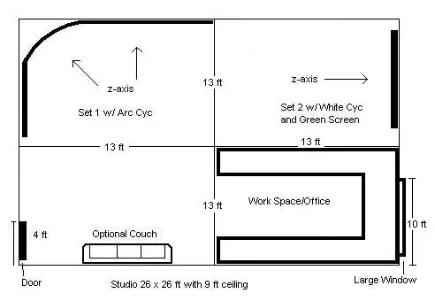

Hello, I could really use some experienced help.
I am designing a studio with 2 sets in an office building space (26x26 ft). I need some advice from experienced pros on deadening huge open space.
I am looking to make or buy mobile sound proofing panels. I have watched film crews use moving blankets and gobo arms for quick lighting and sound barriers but I was looking for something a more heavy duty. Set 1 will be a hard cyc and would be mobile so I will insulate with mixed materials.
I am thinking about making a cloud for the ceiling which is only 9 ft high or fill the existing walls with spray insulation?
I only have $1000 and some change to spend, so I cannot build a total dead studio. Time is a factor too. I am also pursuing options of building the panels. Will pieces of 2-4" foam on panels work? I cannot tear down existing walls or build new walls.

A cyc is a type of backdrop, whether hard, soft, white, ultimatte, chromakey, when you hear cyc think backdrop. I acknowledge your point on the use of PROOF vs. TREATMENT. Ok, in this case I will need to design a studio with Sound Treatment. Instead of photo shoots, I am doing video shoots so sound is a major concern. The drawback is that I am in an office room so I cannot build a total soundproof room. I have to work with what I am given... a challenge. That's why I came here, this is the best audio forum that I know.
I have had experience building sound proof recording rooms on "smalll homerecording style" but I have never worked with pro products like Auralux.
I was looking at building or buying panels or use sound blankets, mount Auralux on masonite or.... well you get the idea.
The design shows set 1 and 2. These are the areas in my video studio I need to treat.
I could really use some sound expertise.

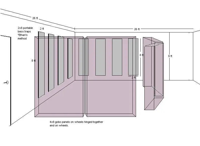

Here is my new update on treating an office space. For the walls, I am making portable 2x8 ft panels bass traps using Ethan's design using 703 rigid fiberglass. I am also making two gobo panels on wheels which are two 4x8 ft hinged together. I am planning on making them 6 inches deep using waffer board, maybe sheet rock inside, and stuff insulation from home depot (R15) inside. Not sure what to do for the ceiling as of yet. I might also spray insulation in the walls... will this help? I only plan on recording talking heads and people teaching training techniques for videos. Thank you.

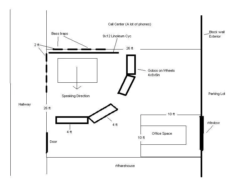

Knightfly,
This will give you a better understanding of my sound issues. At least I am only recording talking heads.
Would an extra layer of sheet rock help (more mass) or once you used one type of material to treat sound, you need a different type (plywood/foam/block) to make futher treatments?

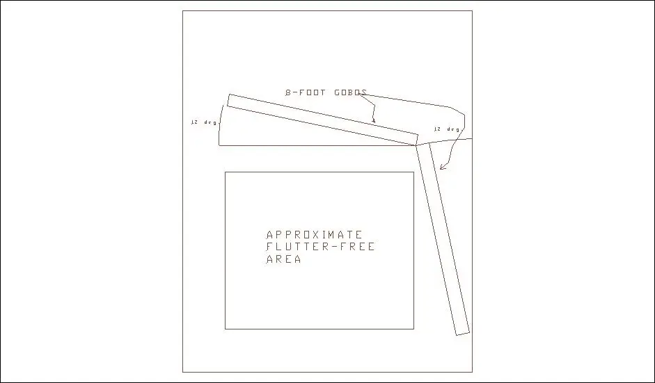

Actually, this is what I meant by setting the gobo's at a 12 degree angle -
