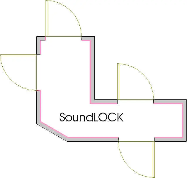

Question drawing
what about this for soundlock:
feedback please

The general idea looks good, but would need more info on actual wall construction, layer by layer, from inner surface to outer - also, where each door leads to... Steve

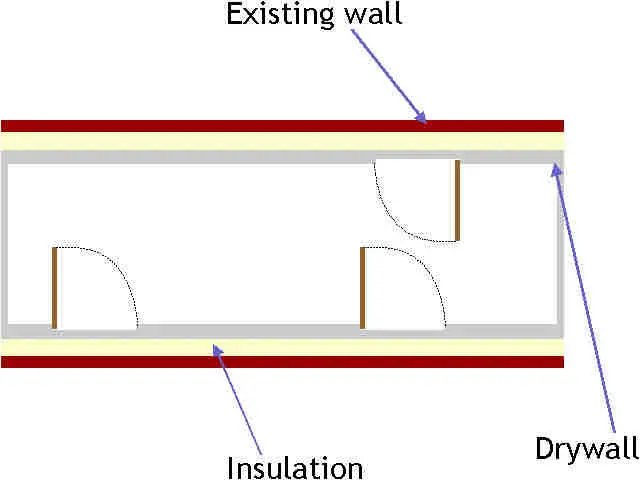

formal plan
thanks steve....
check here... how about building this?

The shape and location of doors is fine, but my main point is that you need to PHYSICALLY dis-connect the framing from door-to-door between critical areas (ones that need the most isolation) - this can be done by completely isolating a wall section with either rubber, or with sound board that is heavily caulked using acoustic rated caulk.
Remember that structure-borne sound can travel farther and faster than air-borne sound. The soft material between sections of the sound lock helps block this, making the sound lock more effective... Steve
