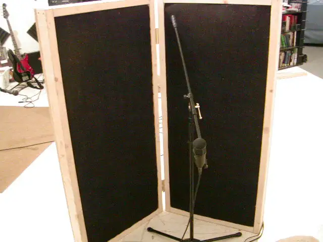

Hay I just made 3 sets
Tip - turn the hinges backwards they will not open all the way
But they will not fall on your toes
Good Luck

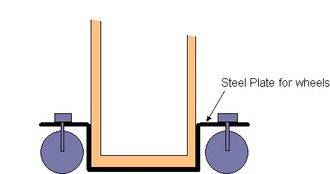

Looks good Randy5235
for your wheels try building something like this. It keeps the gobo tight to the floor.
cheers
john

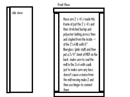

here is a somewhat crappy (but working idea) of how i built mine they are pretty cheap to build and work VERY well i am pretty impressed with how well the work to be honest.
how come sometimes my posted pics show up and sometimes they are attachments? weird

as you can see i'm a hell of an artist
oh yeah you might wanna use cardboard on the inside of the burlap to give the staples more strength
so the staple would go through
cardboard
polyester
burlap
into 2x4
