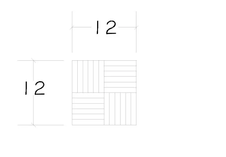

any ideas on how to cut this stuff? i have an angle that needs to be cut in a few. the problem i have is the whole thing just falling apart as i cut it. i have attached a detail for those that dont know what i am talking about. this is one section of the floor. 12"x 12"

Duct tape the bottom side around the edges, across the center, and around where you plan to cut.

so simple! dude you are a genius!!!
