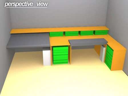

I am building my "studio", that would be my "studio-in-a-room" type of thing...
I attach two renderings to this post just to show you how i decided to do it...
The back of the room is empty because i need to have the possibility to sit someone in the back (like a guitarist and a bass player) when we rehearse, and there is a V-drum set on one corner ( i guess the bottom right).
On the bottom left corner there is the door, that I did not render...
You can turn things around and give me a better layout, just keep in mind the door and the people that should be sitting around.
Oh the grey long thing is the 76 key keyboard...

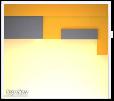

And here's the top view...

jumpingflash - the rendering is a gas gas gas.
First off - I'd put the console in the center of the desk so you get a symetrical listening position around your speakers which I assume will be in the center of the desk. Your keyboard could then be on one side at an angle maybe??

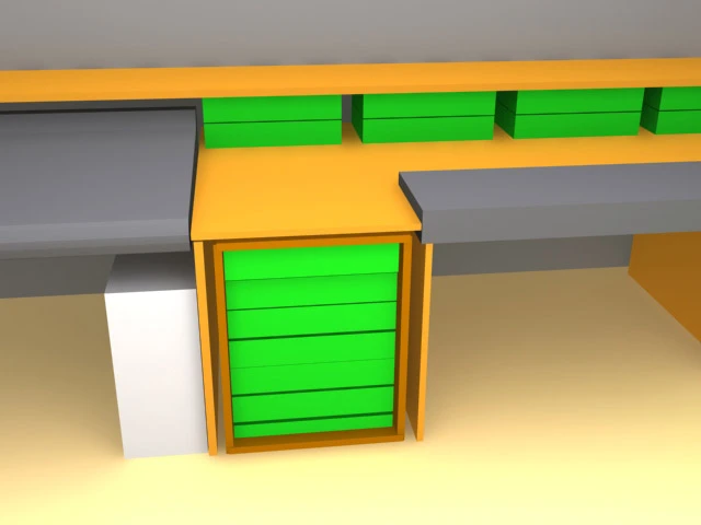

... housing them in a smaller box like this...

That looks like it might be OK. Just my opinion but not only does your setup need to be handy and intuitive to make music on but WHEN something quits working in the middle of a session (and it will) the setup itself needs to be easy to get into to see what went wrong.

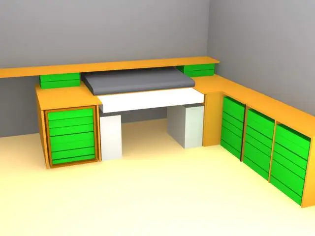

Something like this, so i can put my V-Drums in the left corner there that is empty now...
What do u think ?

yeah that's it - now center them both.

I didn't have a chance yesterday to get back to this thread, but you're on the right track, for sure. (John - That's the picture of the console I was thinking of.)
There are numerous ways you could make a sliding shelf for the mixer. The cheap way is to just build the recessed area for the keyboard with a lip that is flush with the bottom side of the desktop. Then you would just set the board on the lip and put the mixer on top. This would allow the board and mixer to be slid back and forth above the keyboard as desired.
Another option would be to recess some drawer slides that the shelf would attach to and provide a nice, low friction option.
When John talks about getting centered he's referring to being centered on the wall where you are mixing.
As far as making your desk solid goes, try to make the lower sections nice and square, use glue and screws to attach the pieces, and use a piece of plywood or MDF on the back. The back piece will make a flimsy feeling frame into a rock solid cabinet. Then you just attach the top. On the back side, also make sure if you use plywood or MDF to cut some large holes to feed in cabling for your rack gear and provide airflow for cooling.
It seems like a lot of work when you plan it out, but once you finish it, the time spent will be well worth it. You have a great start to what will become the heart of your studio, so have fun with it.

I cannot figure out how to make it slide out anyway...
If i put drawer slides then the mixer would "lean out" and it weights some !...
And where to put the slides ? They should be on the sides, but i either have a piece of wood underneath the mixer that is my "drawer" sliding thing (and to do this i would have to have no real table in the middle of my desk, just the two side towers for the rack units to wich i attach the sliding panel)...
OR i could have a fuxed surface that i cut to inset my keyboard, and then my mixer slides ON TOP of it, like on rails...
Is this possible ?

This is the final layout, the one i am gonna build...
See what u think of it...
Behind the mixer there is some space for a couch or place to sit a guitarist or bass player that wants to add some lines....
