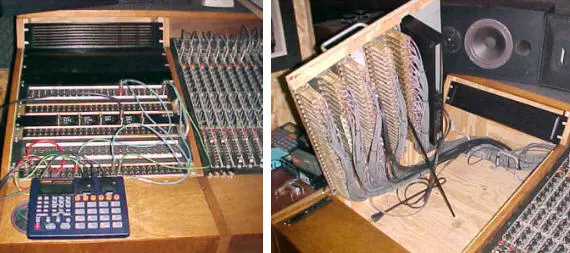

Wire is one the MOST expensive things in my studio. What you might want to consider going forward is buying bulk wire and connectors and solder your own. Plus your wire harness is custom sized to your rig which looks a hell of a lot neater.

Track Rat,
Thanks......, now I have patch bay envy. I was gonna post my measly little bay, proud owner that I am, now I'm glad I didn't.
So where do you pick up the wire? Also, from the looks of things, your patching right into each channel insert on the board. Yes, No?
