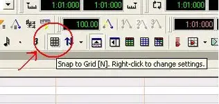

Smile
Hm... you may check "Snap to grid" feature in PRV. Go PRV, and watch this...
