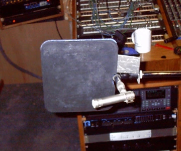

I have another show like this one to record, and I'm going to build a Jecklin disc and use a pair of MC012s with the omni capsules. With the disc rig, you want to be *very close* in to the proscenium: you might even be able to fly it just upstage of the main curtain, if little of the action takes place in front of the plane of the curtain. For the show I have to do, there is no action in front of the curtain at all (other than a few exceptions covered by specific spot or body mics), so this'll work well and be completely invisible.

On the subject home made Jeklin disc, I cobbled this together for use with an Octava omni pair.
