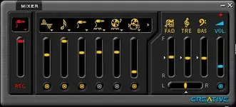

Actually I prefer this mixer...

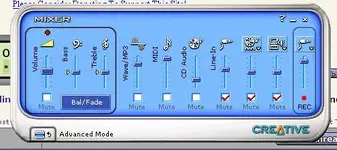

Torpid-x... that's what you call mixer...? hhmmmm.... that looks oooold. You better get this for Creatives...

Those drivers don't support my speakers, or have the toolbar
That toolbar is all I need anyway. The mixer's pretty useless. the only problem (well it's not a problem to me), it doesn't work under Windows XP. I refuse to upgrade to XP for that reason alone. it auto-hides and stays hiden till you click it and hardly uses any resources.
those new drivers don't support my 5.1 speakers properly either.
I Love that toolbar, each once in a while, when licking Sonar I give the toolbar a little love too.
