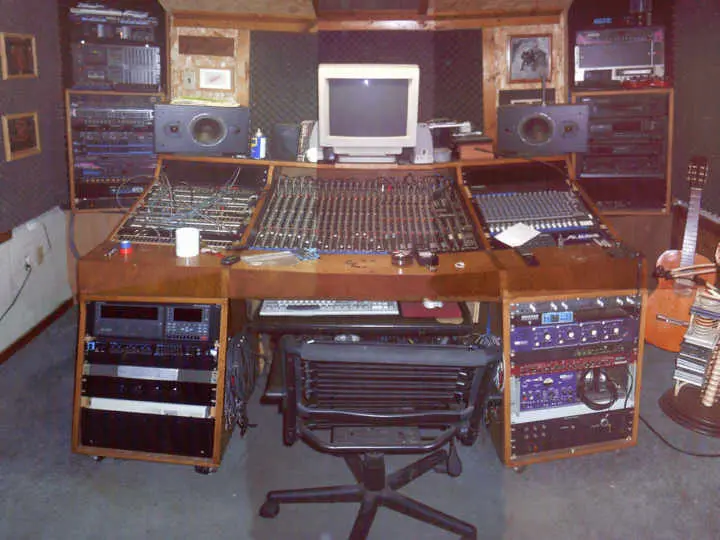

Mr Toad, sorry i haven't gotten back with you yet. Personally, I like your idea. It's my bet that you'll like the way it sounds. The Ghost is a dandy console. I'm using a MOTU 2408 and an HD24 pretty much the same way. I'm using Cakewalk9 with a mixture of plug ins and hardware simultainiuosly. the advantages in my opinion are obvious, it sounds better and it's VERY flexible. The down side is repeatability of a mix. You can still take advantage of software automation but you still have non automated analog faders and EQ. Still, it's what I prefere.
This picture is kind of screwed up, things have changed a bit but you get the general idea
