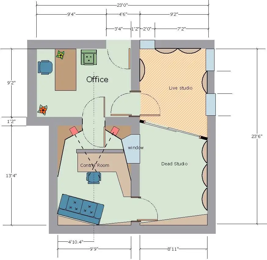

OK Charoo - check this :)
try this layout for your rooms - I've only altered one wall namely the door into the control room.
cheers
john

cool!
its' looking great John! You have trasnformed my place into a proper studio I can say. So there is no need of vocal booth hun? well in the case of live studio, the space you have drawn is quiet big but practically we have a stairs going first floor and it is some how occupied the space, same we are getting a slope slab in dead room on top of stairs, hope you can get the point, should post some photgraphs of my space. You cant imagine but our whole office, including civil contractor, carpainter and architect sitting behind me and enjoying the colors and flowers. luv you !
waiting for your comments !
luv
charoo

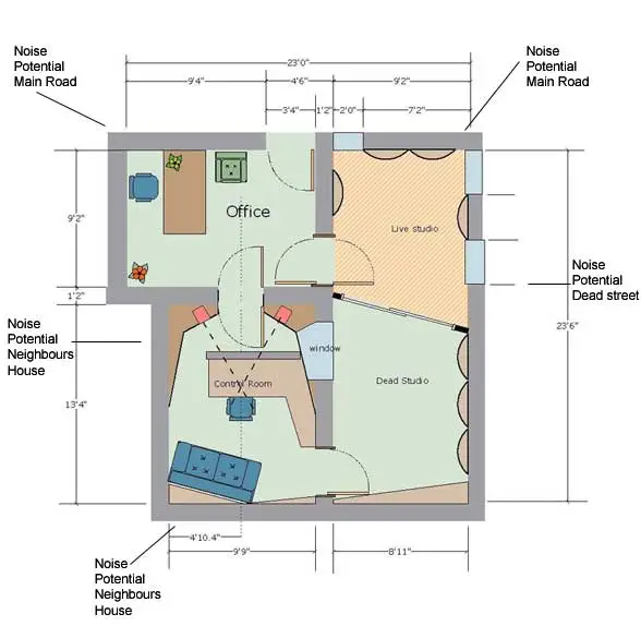

Nosie Potentials around my studio
Hey Friends !
Please check this drawing Originally drawn and conceived by John and just some line and text drawn by me, it gives u a basic idea of noise Potentials around my studio.
luv
charoo

hey john!
Dear John !
FInally i want to use whole space as a studio and i dont need any office space in it as i already have 2 small room adjscent for this purpose. Hey ! all other members also check this drawing and send your feedbacks. in one of of my booth on the right hand of control room i am getting stairs (you can go through at http://www.i-indiaonline.com/movie.htm) going on next floor, so i am getting slope in this booth, it gonaa create any problem or will help us in case of standing waves and reflection. Check this movie:
luv
charoo
