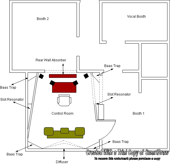

hey ! I have just tried it through Smart Draw, make any sense?
Waiting for ur feedbacks?

okay, now we're getting somewhere!!
Nice one Charoo...
i'm gonna hold back on my opinions, I've talked enough crap for one day, I'll let the pro's take over now

Good job Charoo - that is what I had been thinking too though what you now call "booth 2" is kind of square. Work on the booths next - try and make some non-parallel walls or use Johns wall units to break up reflections.
Kevin.

working on
thanx Rochey for motivating me !
working on other booths like booth1, booth2 and Voice booth. Will come again with some drawings for same. What precaution is necessary for these other booths, I think isolation is one which is really taken care. hun?

I think you need to change the angle of your audio monitors.
They should make a 60 degree equilateral triangle, with the apex at the engineer's position.

thanx michael
thanx for remembering me micheal ! I'll change it my IInd phase, will work out other booths too.

This is sure looking better to me! Good job!
For the booths, they both are pretty small, so my initial inclination would be to make them fairly dead. On the other hand, having one of them more live sounding gives you more options in recording...
Choices, choices, always more choices!
