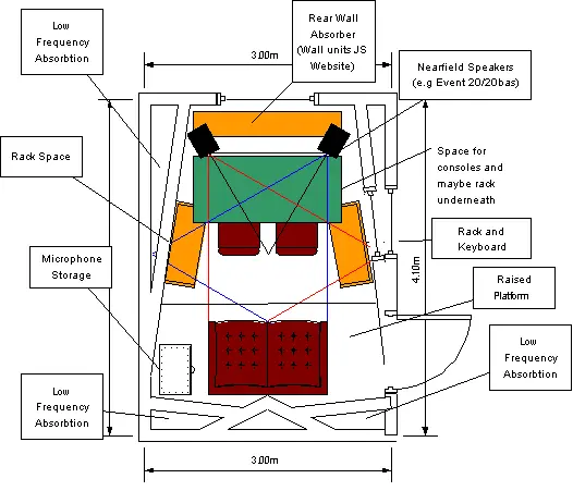

Talking Control room plan, pls don laugh
Deaar Friends,
Kindly find enclosed my funny control room plan, i am just a newbie so bust be have lots' of problem with that, please make me techie like you.
luv
charoo

Charoo,
Thats a great start man,
be careful of things like scale. Meaning, your main speakers look a bit small... Take a look at some of the speaker manufacturers websites. (Or talk to whoever is donating main speakers to you)
They will give you the dimentions of the speakers.
Besides that, it's a great start.
I was wondering... Your control room is shaped much like the bedroom designs that john has on his website - maybe you could copy some of that too.
Cheers
R

hey !
i dont know how but frankly speaking by going through lots' of studio design on Johns' site and other site, i made it like that, well for your note, i gonna use 1029A as nearfield and 1032A as a main monitoring system. Trying to sketch some more too.
luv
charoo

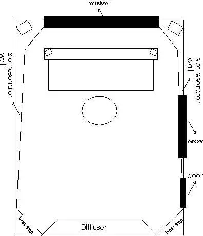

All,
How would this be? I think that the sofa is a little big, but seeing as most sofa's are made in india, could you get a custom smaller one
I've converted charoo's room into meters, because i'm currently having an arguement with Microsoft Visio...

http://www.shoeboxstudios.co.uk/design/charoo
This directory contains the Gif and the Visio file.
PLEASE take it and mess with it... this design was put together just to get everyone started.
Cheers
R

looking good
Wish i gonna sit in this room someday...... well its' cool. Rochey what next for me? give your direction. I am waiting.
luv
charoo

Well,
Don't expect people to do the work for you man. This is just a starter for you, to get you some ideas.
All the guys here have had to learn about acoustics etc because they were designing their own studio's (or designing for others). I know you find the stuff at the SAE hard to understand, but I think you'd get a lot more respect from people if you asked people questions from there, than asking them to do the work for you.
I recommend you go and download a copy of smartdraw (www.smartdraw.com) - they have a trail version thats free. Spend a few hours with it, and see how things go.
Finally, I have one small question for you.
In such a small control room, do you need main monitoring speakers, or will good nearfields suffice?

reply
Well I am not that lazy and opportunist. I always wanna be a harworking guy no matters people admire my efforts or make fun by pointing my untechnicality or amature moreover ignorance of this stream. I dont wanna receive and ready stuff rather i want to workout my own, yaa i just need ur favor to powlish that and to point out the problems and weekness of layout.
Its' not that I am here for making fun, i have strong determination to fight and learn lot's of thing, unfortunately i dont have that brain like you but things gonna fine with me too as I heard if somebody doing a good or pure efforts noone make him back. In case of getting respect or not in India we have a culture that if you want to learn something you have to sit on the feets of your GURU-Teacher and learn, so i dont bother one make my fun or take me seriously as I am here to learn and I keep going learning stuff and nobdoy can stop me or gonna inerrupt me.
Rochey i am downloading the smart draw, it will take some time as speed is really slow of us but I will come again with something drawn by my mind.
luv
charoo

"You want to make the room, so that once the sound has passed your ears (as engineer) - that the sound won't come back This is usually done through absorbtion and diffraction on the back wall."
Well i read somewhere that it can reduce by angled wall too, is it?
"if you angle each wall about 12 degree's away from center (take a look at many of Johns designs) then you can avoid parallel wall problem. "
one wall at 12 degrees or both parallel walls at 6 degrees, am i right?
Angleing floor, I would it would be possible or not but for cieling by offseting 12 degree through some elivation or other, is it right?

Okay... This is all to be taken as "As far as I know" -- and if John or anyone else just as knowledgable know's - then please correct me, or tell me i'm wrong
If you just angle the back wall (compared to the front wall) - the sound will still reflect back to your ears. You need some way of keeping the sound behind you, in which case, absorbtion would be best.
Hmmm, I've got to be honest with you Charoo, i've been thinking the same thing. I think you can do 6 degree's each - although we both need that to be confirmed!
As for the ceiling, you could make a "false" ceiling which had a 12 degree slope. Behind the ceiling you could put low frequency hangers. http://www.saecollege.de/reference_m...requencies.htm
You probably have more questions now than you had before... It's times like this we need some input from the guys that have already built studios!
Cheers
R
