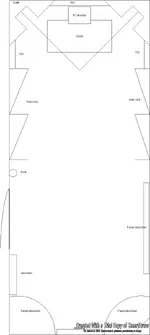

This is my latest plan for consideration

yeah - that's getting there

Would you recomend floor to ceiling on all items in the picture John?

yes I would Ryan.
