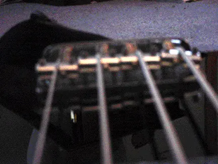

Im gonna have to try that sometime today...but i was looking more closely at the "saddles"...as you call them, is that the real name for them? eh who cares, but mine are all different ways...take a look...

Reading between the lines I get the impression you don't have much experience in setting up instruments?
At a glance it seems that your saddles are not level, they seem to have followed the curvature of the fretboard so first off get them level, individually that is. They should be different height to keep the strings at a constant height above the fret board.
Once you level them up raise or lower each one the same amount. go by the 1/4 turn of the allen wrench, the threads are all the same pitch so 1/4 turn will raise them all the same amount. Hope that is clear. If you really stuff up take it to a tech. Most of my work comes from people having a go themselves first, but its worth it to try.
