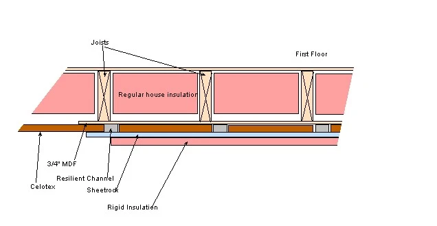

What ceiling height are you working with Kevin?

Just about 8 feet in most places. Under the heat ducts is about 6'8" though. I will cover most all of it with rigid fiberglass.

Hello Kevin,
Did you sealed the ceiling first for isolation and then are you going to put the rigid fiberglass under it with panels, or are you basically sealing the existing support beams as panels and putting the rigid fiberglass in the panels?? Are you using one of John Sayers’s ceiling examples on the SAE page? I am going to start building my studio very soon in my basement, which is very similar to yours and I am kind of confused how to go about the ceiling. I am not sure what would be best for my basement height which is 7.6 feet from floor to support beam and the support beam is aprox 7 inches. By the way I live in Lawrence MA, and work only a few minutes from you in Boxboro.
Thanks,
Luis.

Luis - I made the ceiling as shown in the drawing below. I did seal it everywhere with acoustical sealant though there are a couple of openings around light fixtures where I still need to seal. So far so good... even though the door is not on yet, it really cuts down noise to & from the upstairs.
Boxboro huh? You must drive by on 495. We are near the Tyngsborough line. If you want to stop by some time let me know - I'd be glad to show you what we have done.

Oh....I see how you did it now...thanks a lot for the drawing.
I would defenitely like to stop by and see what you've done so far. There is nothing like seeing something in person. Maybe sometime nextweek or after the holidays I can stop by. I work right of exit 28. Let me know when is a good time for you. I work M-F 9 - 6 so any time after 6 is good for me or maybe at noon time sometime. My email is - luissilvajr@msn.com

hey kevin - that celotex - which version did you use 600 or 800 and what thickness. The figures I read on it indicate that it's as good as rigid fibreglass in it's absorption curve.

Hi John - I'm not sure what version it is. It is 3/4" thick and is labeled "SOUND STOP".
