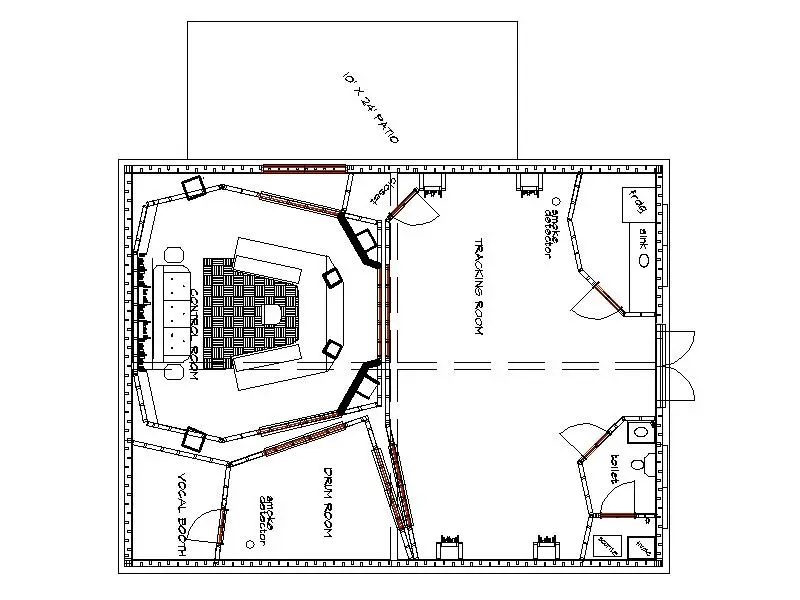

I am building this (attached) studio right now.
I'm in the very early stages, forms are being set for the foundation as we speak.
The nominal dimensions of this studio are 30'w X 40'l X 10'h.
The height actually varies from 10' - 14'.
It has a
Control Room
Tracking room
Vocal Booth
Drum Room
Bathroom
and Kitchen

Thanks for the input Michael, I really appreciate it.
That is a very impressive layout. I hope it
goes well! I already am thinking of changing my
buildings dimensions after seeing your layout.
I like your 30' width better than 24' we were looking at.
We can change our dimensions easilly since we are
purchasing a building kit for the main structure,
which is actually cheaper than if we
build it ourselves- (inlaws are custom home builders).
I will be pouring my own concrete slab, and finishing
the whole thing ourselves.
Have you ran into any difficulties with getting permits?
Thats my next hurdle to jump. We live in Oregon near Portland
and the local counties are a joke to deal with regarding
building permits. At times worse than congress.
Happy building!
Sky Pilot
