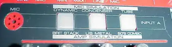

I can't apply the mic simulations to the internal mic, even tho there is a line connecting them all in a group. Odd.

ok, what's the deal here? In the Musicians friend catalog there's a big full-page thing about how the guy likes it, etc. and the internal mic, "...especially with the mic simulation butttons...." -Reg Hamilton
The manual doesn't seem to even imply that it can be done. I haven't been able to do it.
Hey Reg, can you explain how you got the mic simulation buttons to work with the built-in mic?

I got email from Fostex:
"...Mike Simulation doe not work with Internal Mic.
The MIc simulation only works on INPUT A and when INPUT A SWITCH is set to MIC/LINE..."
So there's my answer. Good to know my machine isn't malfunctioning. Interesting to note that the Musician's Friend catalog writer is full of S**T.
So from now on, if that catalog states that the guy USED some new equipment they are trying to sell, don't believe the so-called writer had any experience with it. If you can, come to HR BBS first, if it's a feature you really need, you better be sure your unit actually has it. This feature wasn't a decision point for me, so not too bad.... Really, whadda ya want for $300.
BTW, no EQ.
