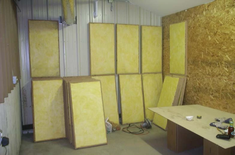

703 in captivity...

Quote:
Originally posted by Dan Merrill
703 in captivity...
Right on Dan!
A whole heard of 'em too!
Thanks.
