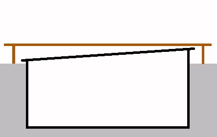

Andrés,
Here's an alternative. Instead of making it a dirt roof, make a normal roof and put a patio deck on top. You'll still be able to use the space, but the cost and hassle should be much less than with a dirt roof.
barefoot

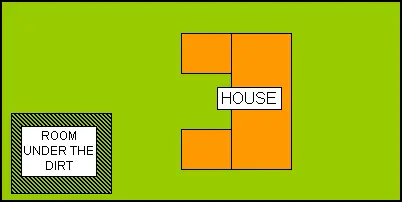

thanks Barefoot. I am attaching a small plan of what it looks like, so it's more graphic to you guys.
This house has no basement. I will find out if this are has drainage problems. I lived 5 kilometers from here and there was a problem with the "napas", which is how we called the water that is under the dirt. But this place is much higher. There is a hhighway that goes up and down thru the region. This place is in the up side, where the highway goes like a tunnel.
I also thought that being so isolated could bring problems dealing with low frequencies.
