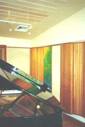

it looks like this

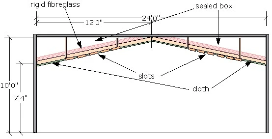

Voodoo - it looks like you need to drop the reverb time across the full spectrum - try something like this, its a broad band absorber with a slot resonator built in. My posts are around the wrong way cos I forgot to attach this drawing.
cheers
John
