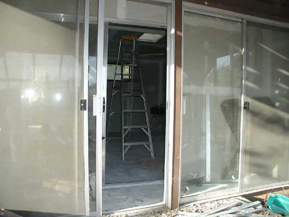

Right on you guys. Rochey, here's a couple of photos.
First is a view from the outside (my future control room? ) back into the live room.

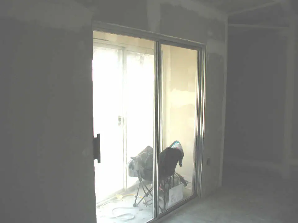

Next is inside looking towards the east wall (doors are on the south side):

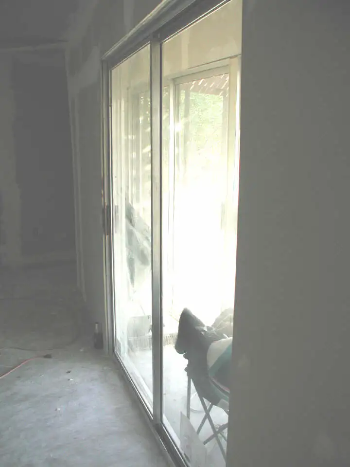

Last is a similar view but from the opposite side (towards the west wall).

Cheers Buddy, I understand what it all is now....
looks cool, I was thinknig of doing the same in my studio... someday...
