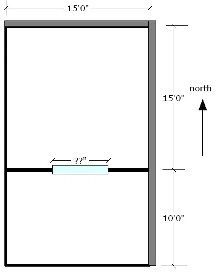

First - have I got the dimensions correct??

Cool John. Ill get all the dimensions. The ceiling slopes down i think about 2 inches. Do you want me to include all that stuff too? I will give you as much detail as i can get. I will begin a layout of everything tomorrow and post it up for yah. Thanks again John.

This is the best layout i can give you of the studio because i dont know how to use cad stuff very well.
http://www.srv.net/~apress/slowrecor...dio/studio.jpg
This is pretty accurate although it might not be right on the cm . The ceiling is 7 1/2 ft tall. If theres more info you need, let me know.
