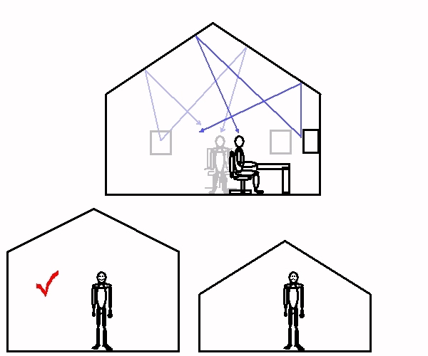

I've got a vaulted ceiling..but
Which is better: to have your monitors in line with the apex, or set up across the angles? If you see what I mean? ie sloping walls on either side of monitors or sloping walls in front and behind?
Reply With Quote

Quote:
Well, it depends on the geometry of the room. You would need to look at the where the first reflection points are in both layouts. The analysis is more complicated because you are dealing with compound angles. A refection that appears to intersect with the listener from one perspective actually might not when you analyze it from the 90 degree perspective. I’ve attached an example graphic illustrating both layouts from a single perspective. This perspective might lead you to choose one layout, but rotating the image you might possibly come to another conclusion. Like I said, it all depends on the specific geometry.
I’ve also included a graphic of what I mean exactly by vaulted ceilings. I’m talking about the types of rooms with normal wall heights, not attic type rooms with truncated walls.
barefoot

Quote:
Originally posted by cordura21
I also read that raisng and angling the monitors also helps avoiding standing waves, just keep sure that they are still pointing at your ears.
This actually is more of a solution for wall and mixing console reflections rather than for standing waves.

Quote:
Is the unhappy guy in your picture unhappy because you're not talking about his room or because his truncated walls are a bad concept all together?
Reply With Quote

Quote:
Well, for a given volume room angled walls are better. But rooms are generally based on floor area, so truncated walls will almost always mean less volume and closer reflective surfaces. In most cases I think you would be better off having a larger volume rectangular room. This leaves you the flexibility to build angled partitions and use the volume behind them as bass traps.
barefoot

I'm in a room similar to your 3rd guy.... the one with the frown. Truncated walls are 4 feet tall. Room is 15 feet wide between the truncated walls.... and 22 feet end to end. 8 feet tall in the middle. (it's above a two car garage). Best acoustics I've ever had in any home studio.
The vaulted ceilings make a huge difference.
The only bummer is that everything I take in and out of the studio has to be carried up or down stairs! And I'm getting way to old for that!!
