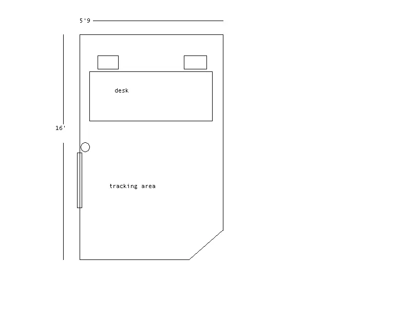

I have attached a file that shows a rough drawing of my room. I have been looking into Johns studio setup
ala http://www.locall.aunz.com/~johnsay/
John turned me to that as a solution to my 250 500 hz issue ( I will post the modes in a followup post )
I am about to build the wall units and want to put the other absorption pieces in but space appears to be a serious factor for me.
The corner bass traps being 2ft by 2ft does not leave me much between them for the front and back wall pieces.
My question is, is there another option for me? like in the Everest books it gives the specs on building 1/4" pegboard boxes with 703 that gives .97 absorbtion at 250 and .99 500. If I put something like this in the front and or back what should I do for better bass absorbtion in the corners that does not take up the whole wall?
Does this make any sense?
Thanks for any help
Ryan

The mode totals give these results
TOTALS 125 Hz 250 Hz 500 Hz 1000 Hz 2000 Hz 4000
SABINE 61.56 43.24 54.8 98.78 144.35 151.74
REVERB 0.53 0.76 0.6 0.33 0.23 0.22
Thanks again

Ryan,
In the attached article Ethan Winer suggests putting two of his larger/deeper bass traps at corner intersections. Not sure if it's as effective but most likely pretty good and it will save you space.
http://www.ethanwiner.com/basstrap.html
Alex
