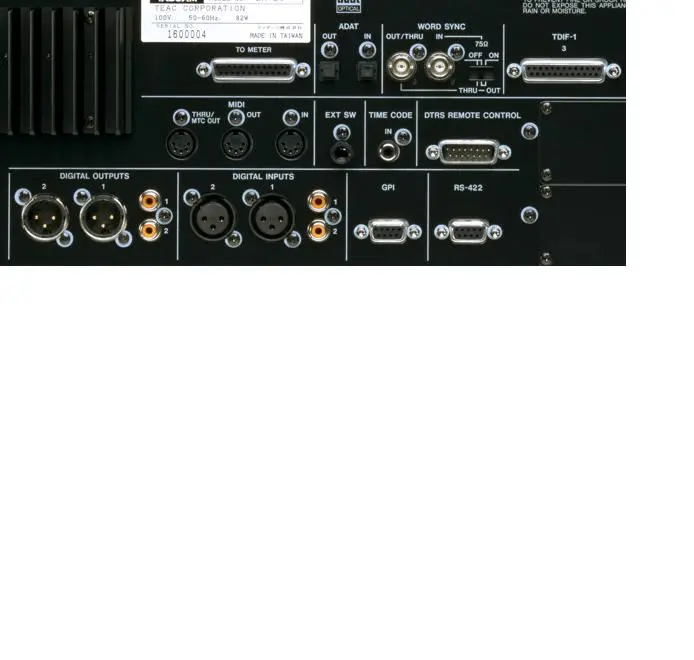

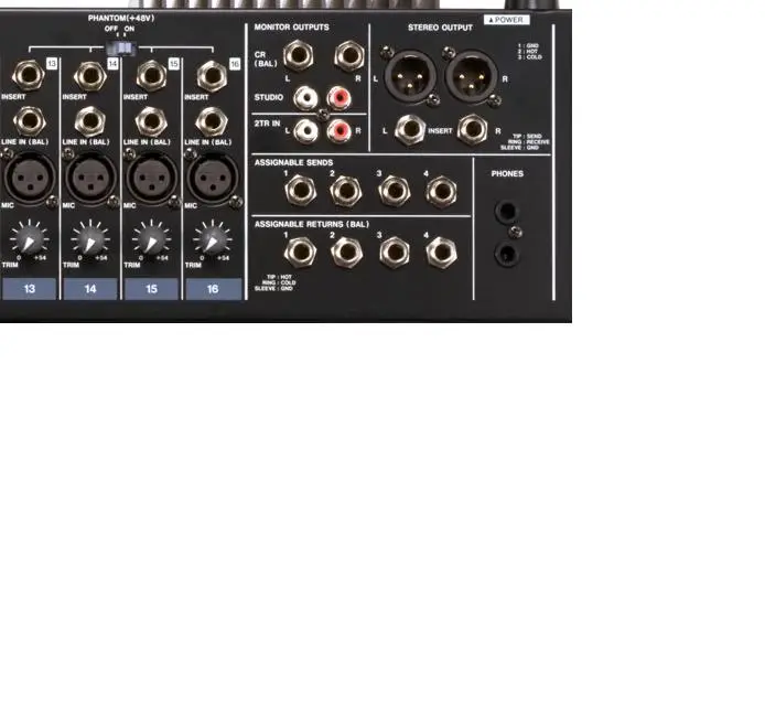

I've attached top and rear views from the Tascam site. The top shows 4 sets of balanced send'return jacks among other things.

Here is the rear shot - both of these are just the connector area - too large for attachment otherwise...
