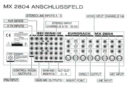

console
i have attached a picture of the back of console .
if you could give me some other ways of doing this.
i am not good at all when it comes to setting up consoles and or other attachements.
i can play guitar and other instruments but! this stuff it just blows me away .

Use the Direct Out to send that channel to the recorder.
Use the Aux sends to go to the reverb. Send the reverb output into the Stereo in 9/10. Set the effects mix on the reverb to 100% wet. Use the Aux knob on the channel you want to send to the reverb unit. Control the overall reverb level with the 9/10 slider.
The effects will be heard while playing but will NOT go to your recorder.

console
ok i have used direct channel to my computer.
now i have set it up as you instructed
though. i am still getting
reverb going through..
also the effects are coming through
pre not aux
these things drive me nuts..

console
well,
the 9/10 channel do work. with the slider.
what i am saying is that , aux send is having no effect in controling the fx .
it's the pre that is adding fx.
also for some odd reason the fx is still going through.
i have all the setting down on 9/10 except the fader.
and on voice as example i have the fx on
and it keeps going through to my computer to my recording device in my computer..
