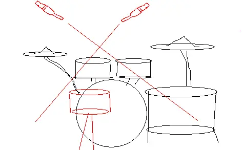

Here's how I did mine. Remember to keep the two overheads the same distance from the snare to avoid phase cancellation. I don't know how right this is, but it turned out good and a guy in the mp3 section said it had a really nice w-i-d-e stereo image. Panned one hard right and one hard left.
Christopher

I have been imersed in Harvey's " The Mic Thread" that si available in a printable friendly format.
Just yesterday I was reading Harvey's comments regarding omni mic's and stereo imaging. He indicated that to get discernable stereo imaging from a pair of omni's that a greater distance between the omni mic's is needed than would be used for more directional mics.
While the equidistance rule to prevent phase cancelations sounds good; the 15" apart sounds much too close to acheive the greater ditance of seperation needed for stereo imaging...but then distance is very relative term.
My impression was that the directional overheads would towards the outer edges of the kits and the greater distance needed for omni's would be closer to 6 feet apart rather than 15 inches.
Then again that was just my impression...I have not mic'ed any drums yet...not enough mic's or drums or rooms.....
That has been my experience. The only instance where I would put them closer together than that would be if I were recording with a binaural setup . . . which really isn't a bad idea, come to think of it. If you could put together a makeshift binaural head and place it somewhere above the drummer's head, or next to it or whatever.
Maybe that was the idea behind tubedude's thread. If you could place the Right overhead as close to the drummer's ear without him bumping in to it, it might create that sort of effect (very loosely).
Other than that, I would space them as far apart as possible on either side of the kit.

Thanks for the drawing Chris! I'll experiment with the placement you suggested.
