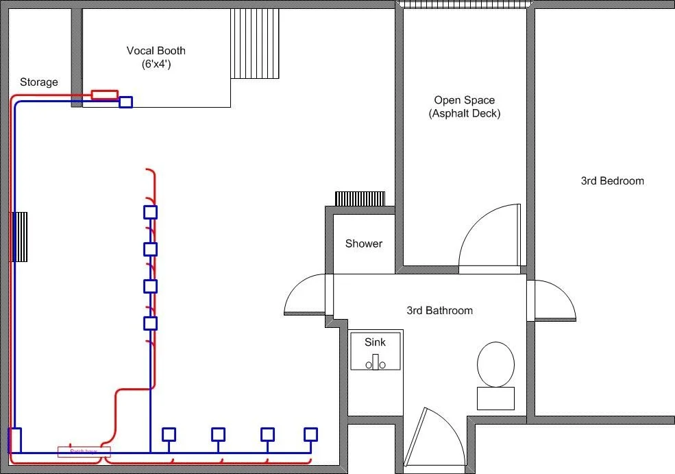

Here is my floor layout:
http://members.aol.com/midimonkey732.../floorplan.gif
At the top of the picture, you see the vocal booth "over" the stair well.
Immediately to the left, is an area called "storage", which has a slanted ceiling, almost to the floor. The vocal booth does not have a slanted ceiling, its weird, but try to picture it.
On the inside of the wall thats against the Tascam TMD1000's area, on the inside, are two junction boxes. The lowest junction box to the floor is the one for power, which has four ordinary 3-prong outlets installed. The conduit comes out of the box and goes through the wall into the "storage area" immediately to the left along the floor, bends by the leftmost wall of the room, then down the diagram to the leftmost corner, where my 60A breaker box is located in the corner. All inside steel conduit.
For the audio, I basically did the same thing, except I used a 4-gang junction box at about waist high from the floor in the vocal booth, ran the conduit through the same wall into the storage area all the way to the leftmost wall, then at waist high, all the way to the bottom left corner like above, just 3' higher than the electrical conduit. Because the storage area ceiling slants so steeply, the power conduit is on the floor pretty much, and the audio/midi/digital signal snake is at the ceiling of this area, even though its only about 36-38" high. Leaves the storage area open enough I can toss junk in it. Right now its a mouse hotel, but thats another story.
If you really need a drawing, I'll be glad to do it sometime this week, and of course, answer anymore questions you might have. I believe I still have the wiring diagram for my entire studio on this laptop, so once I dock in boston I can make my plans available if AOL cooperates with my uploading them through the web.

I found the diagram after all... now to scoot to Boston.
Real quick though, you'll need to view both the floor plan above at the html link as well as this diagram to see why things bend the way they do.
But in a nutshell, blue is electrical, typcially on the floor or very close to it (I mounted all the outlets on the bottom half of the diagram on the floor), and the vocal booth outlet is close the floor, but actually in the wall.
The red is audio, midi, rs232/rs422, "other" type of cabling, typically part of the Mogomi 24-ch snake reel I purchased last year. The vocal booth has 24 TRS pairs used for audio, midi, etc as i mentioned earlier, and the four racks along the bottom of the diagram has 48 TRS pairs per rack. This provides balanced audio (which most synths don't need, but its there anyway) as well as Midi. Some racks that have drum machines and synths with individual outs (typically 8 or 10) "steal" connections from neighboring racks. And yes, I have this all in a nasty spreadsheet so I can keep track.
At the bottom left of the diagram is a blue box - thats the electrical breaker box for the studio. Right now it has two 15A circuit breakers and one main 60A breaker, and I can upgrade to three 20A breakers at some point should I ever need it. One breaker for computer stuff and the overheads above the console, and one breaker for all the audio gear.
The neat thing about synth modules and outboards in the four racks at the bottom (and pretty much all the audio gear I have) is they draw very little current - but theres a lot of them. So 15A actually is about 1A more than I need when I power things up. Run current is about 12A on that breaker.
This diagram should give you a little better picture of how things are routed. Blue is electrical, red is audio/midi/other.
Reply With Quote
