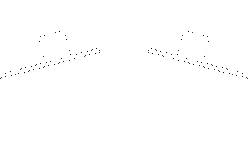

I have a design recipe for building RPG type quadratic residue diffusors that I could dig up for you. But, they require a fair amount of material and aren't particularly easy to build.
A excellent and fairly cheap solution is to flush mount your monitors. This has many advantages which have been discussed here in previous threads. You can even do it for nearfields like I've illustrated in the attachment. Thick Plexiglas would be a great material to use to avoid any cramped feeling you might get from the baffles being up in your face, but then that's very expensive.
The major disadvantage would obviously be the space and the limited access behind the partitions.
