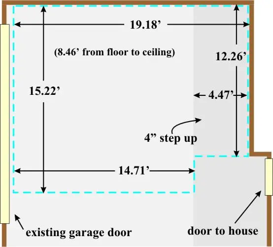

The dotted line in the attached picture represents the maximum amount of room I have to work with.
What I'd like to do is divide that space into a live room/ control room setup for home recording. Most of the time I'll be going the electronic route for drums, with live instuments and vocals, but I'd really like to keep the option open for recording an accoustic drummer with a four or five member rock band (for example).
I'm willing to angle walls, construct double thick walls, and add whatever sound absorbsion and/or diffusion that is necessary. obviously I need to isolate the room for sound as much as possible.
Is it even reasonable to do this given the amount of space I have. I know someone who built a home studio with less space, but he gets less than satisfactory results and there's no way to fit more than a guitar player, bass player, and a drummer in his live room at one time.

Ya know it doesn't matter if it's possible......that's how much space you have so you have no choice. And that's a hell of a lot more space than I've got. I would put the priority on the control room and let the live room get whats left because you'll be doing the crucial mixing there and it has to sound good. Then whatever's left for the live room and do the best you can with that. Just my opinion.

The entire space you show would make a pretty good sounding control room, or a reasonably good sounding tracking room, but not both. If those are the dimensions BEFORE any double walls, etc, then the room gets even smaller as finished. Small room acoustics tend to suck for the most part, because it gets harder to achieve proper modal spacing to minimise glaring room resonances. I would use the whole room for a control/tracking room, and use the corner outside, next to the door into the house, for a machine room (computer, ADATs, anything that makes noise) - a non-symmetrical room makes it hard to get a balanced listening position, but a smaller room doesn't pass the Bonello test using your other dimensions. Check out my post in this forum on parallel walls for links to spreadsheets that will help you work out optimum room dimensions. F. Alton Everest's book, Sound Studio Construction on a Budget, $20 from Amazon.com, has some good usable design info for walls/doors/floors, etc - you might be able to use part of that jog extension on the right side of the drawing to make a sound lock door setup.
With some good closed-ear phones for tracking, a single-room studio is doable, and it would be a lot less cramped than the same space with a soundwall between two "closets" - speaking of which, while you're at it if the house has a large closet in the master bedroom, now would be a good time to run a couple of cables under the house to the closet so you can use it for a vocal booth later (if this would be an option) If that space were what I had to work with, I wouldn't chop it up. Just some thoughts... Steve

Funny you should mention that... I've been using the master closet for vocals already, and my den for a control room.
The point of moving to the garage was to be able to work at odd hours when the family is sleeping. I guess I could still do the composing/aranging/recording using the big room at night, and record vocals in the closet during the day.
What you say about using the whole room makes a lot of sense to me, and it has the bonus of costing less. I will check out the link you posted. Thanks.
