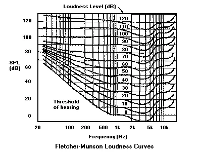

That's the effect of the Fletcher-Munson curve. That's the way your ears deal with bass and treble at different volumes.
I got myself an SPL meter Rat Shack (about $40) and use it to set my playback/mix level to 85dB "A" weighted. I feel that always mixing at the same "loudness" I at least get mixes that are consistant in their balance.

Hey, thanks guys..... after posting this, it suddenly ocurred to me..... I can't believe I had forgotten about the old Fletcher Munson.... I was actually copying a picture of the graph when I checked this messageboard again. Then what you guys said pretty much confirmed what I had been thinking... and I think I have an ironic solution which I'm gonna try tonight......
*talking out loud to self* On all the snare tracks that have that midrangy hit, rather than boosting that, I will CUT it, or whatever frequency was the only one "poking through" at lower relative volumes. Then, I can raise the level of the snare track more, and because the midrangy peaks are reduced, by the time I get those same frequencies at the level they were before, it will be as if all the others were boosted, making the drum sound fuller. Before, I was doing the opposite... I was boosting the midrange, which is essence, pushed the rest of the frequencies down.

Can someone post a pic of the Fletcher-Munson or gimme a link?

It's not the greatest image, I'm sure someone has a better one (and hopefully so, so I can print it out), but you should at least get an idea from this.....
